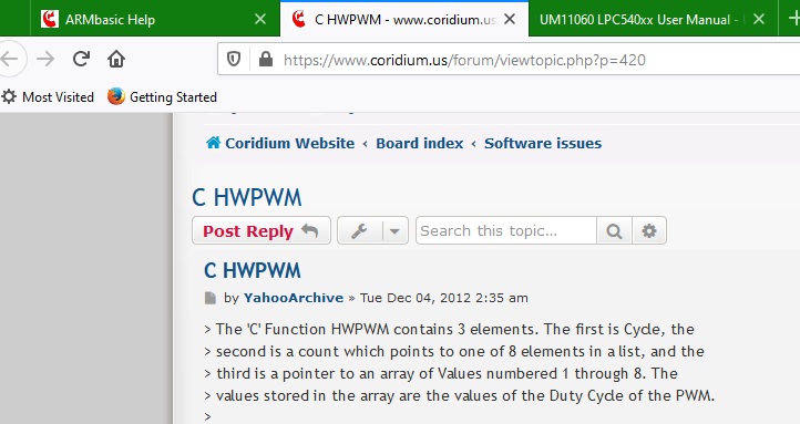

Was perrusing the online HELP file for information on __ASM__ topic.
two bad links : 1) the 'ARM7thumb.pdf' isn't avail
and the 'forum' link is ???? [not related?]
Olzeke51
Re: Documentation, broken link
fixed, thanks, happened when the website changed ISPs
