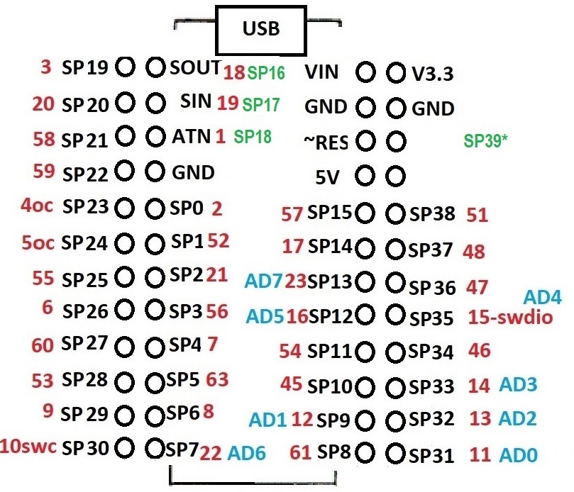

Re: ARM stamp - LPC11U37 Pinout
Posted: Sun Jan 14, 2018 8:40 pm
- stamp.jpg (180.93 KiB) Viewed 86432 times
The numbers in red indicate NXP port/pin definition, which Port0.31-0 are 31-0 and port1.31-0 are 63-32
oc indicates the pin is open-drain or equivalent to open-collector
swdio and swc are SW debug pins. On reset they are SW pins, but when BASIC starts these are made to be IOs
The SP numbers in black are defined in the #include file STAMP_PINS.bas. They are also #include'd by LPC11U37.bas
Posted: Sun Jan 14, 2018 8:50 pm
SP numbers in green are special purpose pins, but can be used as IOs with restrictions -- see help files for more details.
AD numbers are AD converter inputs
