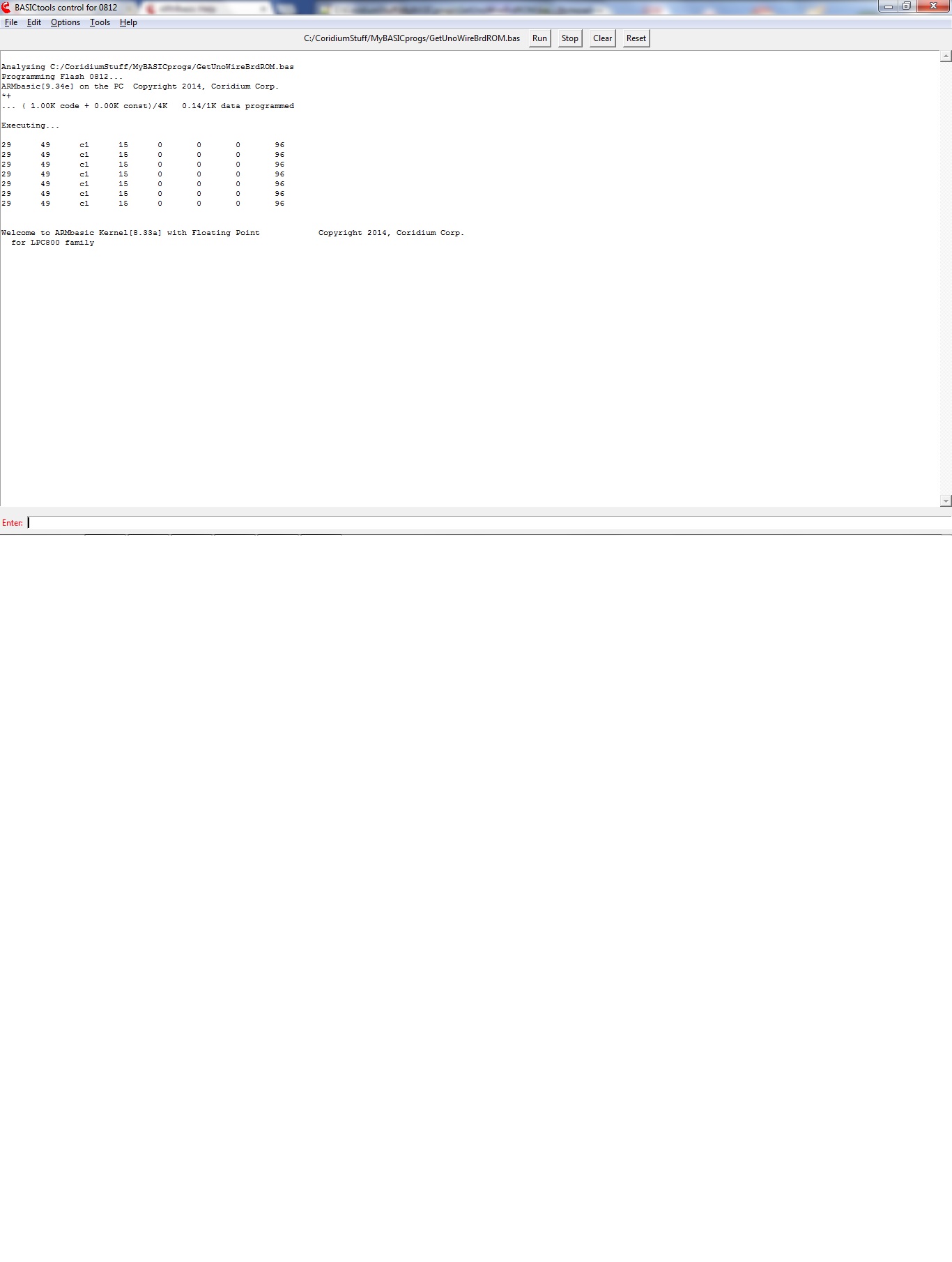

I received my PROstart and LPC812 boards last Friday! Being a 1-wire guru, I wanted to test the 2 boards interfacing with some 1-wire devices. I was disappointed to find the existing 1-wire BASIC driver not functional. So I whipped out my LOGIC analyzer and started tinkering with the existing driver. The attached driver and example file is a preliminary work tested with the PROstart board and my unowire board. I hope to expand it to add the rom search function as I use multi-drop networks most of the time. With the attached driver you can at least get 1 rom and read/write bytes. Please let me know if there already is an existing driver to do more functions! I looked around on here quite a bit before I began my tinkers to make it work.

Just wanted to update with info about usage of this driver with the LPC812. It works also! I tested with my unowire board having a DS2408 (8 channel I/O) to get its ROM id using IO17 of the LPC812. Lots of ideas flowing through my head with using this gadget now!
