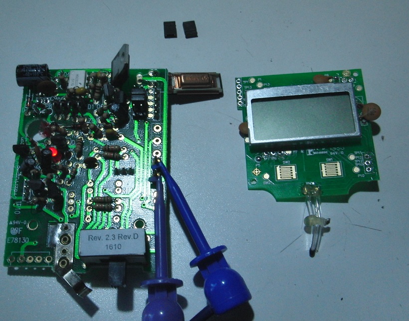

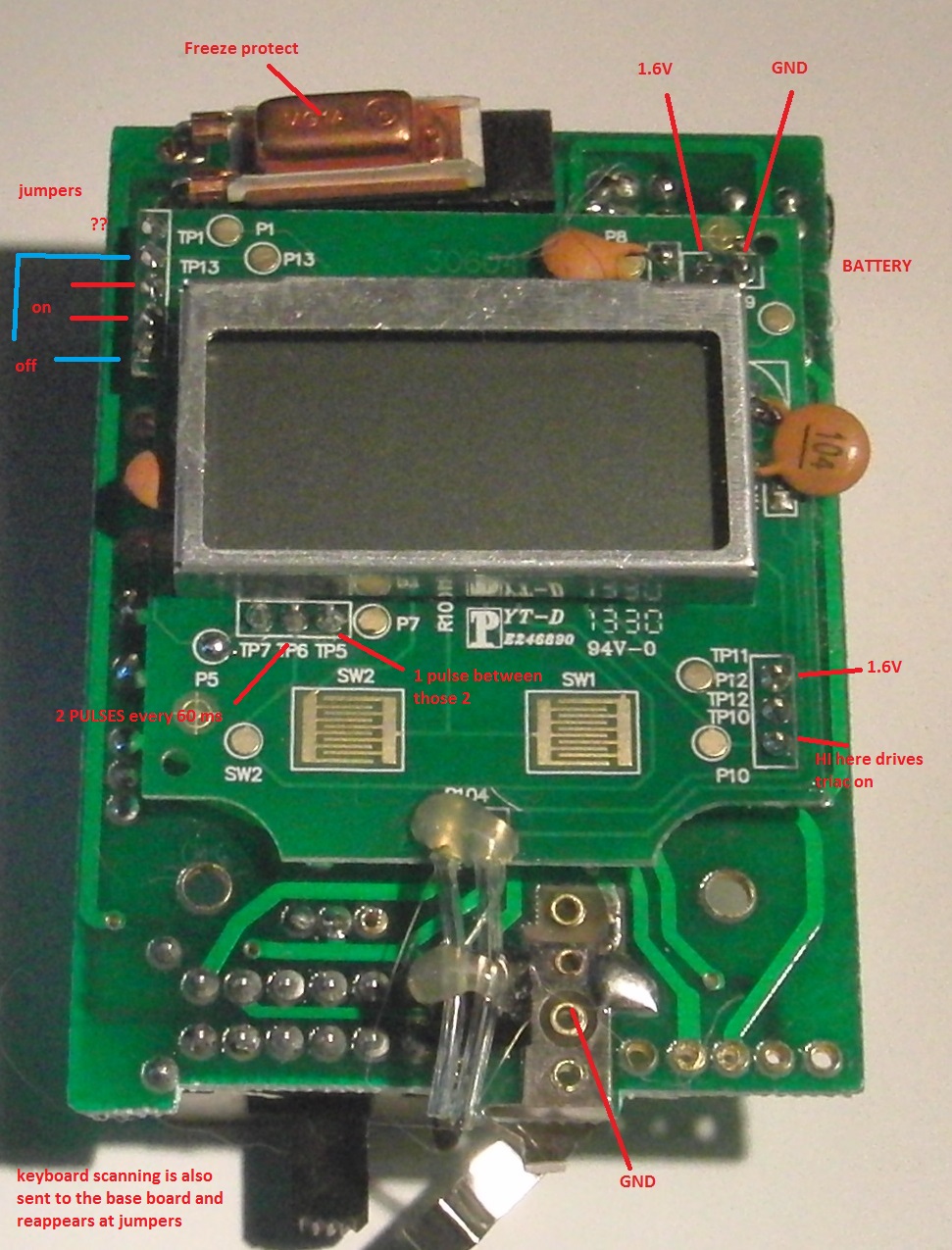

Back at the teardown of the existing thermostat. An interesting piece of 60s and 90s technology. The base board all thru hole, a half dozen transistors, a triac and triac driver for the heat demand switch. Looks like 2 different diode bridges, not sure why that is and an LED not visible from anywhere, must be used in testing. I won't bother tracing out too much of the base board, as all I want to save is the display board. The display board has a single chip micro mounted as chip on board, display, a pot and some bypass caps. The bypass caps are still through hole (really??). It runs off between 5 and 50 microAmps at 1.6V. And at least it keeps temperature, not sure I can fool it into indicating on or not, might just have to add an LED for that.
After reading a number of blogs I see this also has a bi-metal fail safe which shorts out when cold (the copper thing I bent away from the board). Got the old can of cold spray out and verified that. Not sure what it is set at probably around 40 degrees. Seems like newer one has no such thing, and the newer thermostats don't seem to have that anymore. I assume with fewer and all SMT parts reliability is improved by orders of magnitude.
Not sure what the need for the temp sensor on the battery is for (the small black thing hanging below the display board), I doubt they are trying to charge the silver type battery.
Re: DIY WiFi Programmable Thermostat
actually that is the temp sensor for the whole thermostat hanging off for better thermal isolation. It seems to be checked every few seconds. In the upper left hand corner of the display board there are 4 jumpers, not sure what those select. Looking to figure out what some of the other 6 connections do.

Finishing up custom PCB, here are the connections to the micro/LCD board.
