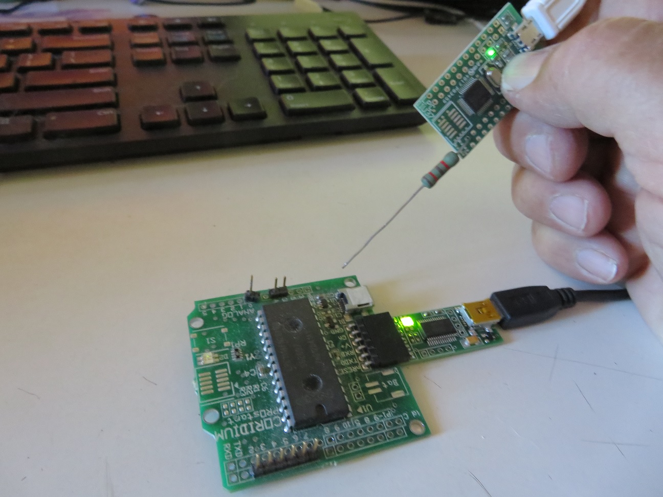

A simple logic probe
Generated by a customer need, a simple logic probe is a great aid in debugging.
This uses a GPIO to detect high or low on the pin, and using weak pull up/down to detect floating lines. And with a normal weak pullup to detect falling edge transitions to show pulsing signals.
Here is the program--

Possible improvements would make toggling indications represent the toggle frequency. Obviously you can't see 1 MHz or even 1 KHz, but it would be nice to flash at different rates. Currently the toggle indication just flashes at a visible rate for both, but some difference in rate would be nice.
