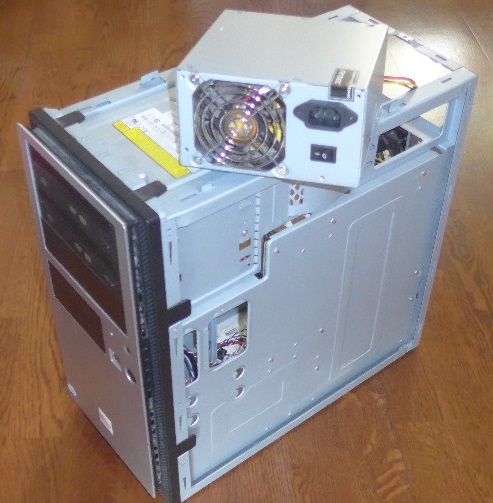

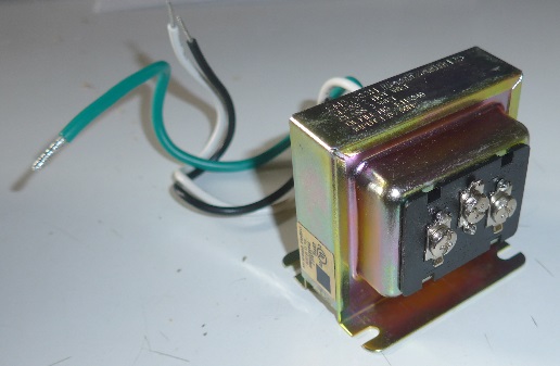

To get started I did not want to develop the project on the existing heater controller, which could be an expensive proposition if I did something bone-headed. So I picked up a 24VAC/16VAC transformer at the local Ace Hardware.
I've had lots of experience working with high voltage, and also being shocked a lot, so first I decided to build an enclosure for that transformer. I had a few boxes lying around, but seems to me like an old PC power supply, gets me halfway there, AC power plug, switch, box to get started. I guess I'm voiding the waranty :)

OK getting the power supply setup. A handful of junk box components makes a 24VAC supply, that I don't have to worry about exposed 120VAC or at least it is a lot more stable on my desk

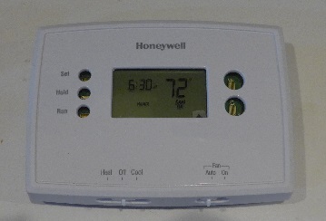

As for the thermostat, while this is the one in my house, it is no longer generally used. Partly it is pretty old tech nowadays, lots of through hole parts.
So I picked up a newer one at Home Depot (less than $20), which will be a better example for others, this is a Honeywell RTH221B

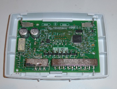

And the more modern all SMT design.
I plan on using the housing, power supply, relay, maybe temp sensor and interfacing those to the WiFi module. It should save a lot of time.

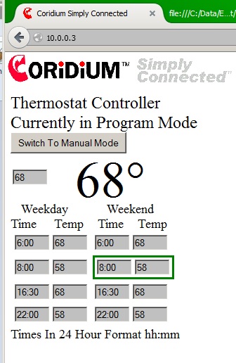

The goal of this is to do the thermostat control program in BASIC and for it to also serve a webpage as the interface to the end user. That programming is nearly complete, as that work started a few months back. As I know, hardware without software is pretty useless. Here is a snapshot of the webpage you would see on your phone, tablet, PC, Mac, Linux machine or whatever.
Originally I was thinking of doing some cross platform app. But by going with a webpage, that is about as cross platform as it gets and doesn't require much programming on our side beyond some HTML.

On the programming side, to show the communication between webpage and user BASIC program, these are preliminary sources for BASIC and the HTML. The firmware on the device services the webpage and handles the CGI requests that can set or read values in the BASIC program.
Web source (phpBB does not allow HTM uploads)
Thermostat.zip
(1.26 KiB) Downloaded 2136 times
And the BASIC program
Thermostat.bas
(12.78 KiB) Downloaded 2358 times
Hardware definitions for STM32F411.bas
STM32F411.bas
(55 Bytes) Downloaded 2004 times
The include for parsed.bas is a placeholder file that we are using until the BASICtools gets caught up to compile the HTML page and add it to the downloaded hex.
