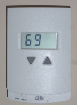

This is something I want for my own use. I want to replace at least one of the thermostats in my house with a programmable design, that can be controlled over WiFi. Here is one of those thermostats.
Some more details on my use. My system is a heater only, and as a radiant system, all the thermostat does is say its cold or hot.

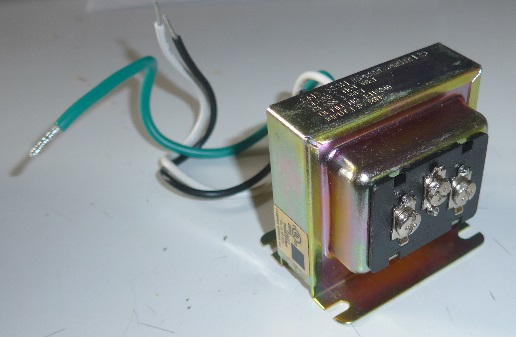

To get started I did not want to develop the project on the existing heater controller, which could be an expensive proposition if I did something bone-headed. So I picked up a 24VAC/16VAC transformer at the local Ace Hardware.

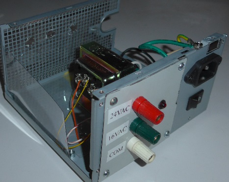

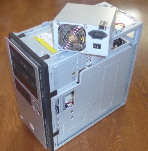

I've had lots of experience working with high voltage, and also being shocked a lot, so first I decided to build an enclosure for that transformer. I had a few boxes lying around, but seems to me like an old PC power supply, gets me halfway there, AC power plug, switch, box to get started. I guess I'm voiding the waranty :)
Re: WiFi Programmable Thermostat
Posted: Mon Apr 11, 2016 12:00 am
OK getting the power supply setup. A handful of junk box components makes a 24VAC supply, that I don't have to worry about exposed 120VAC or at least it is a lot more stable on my desk

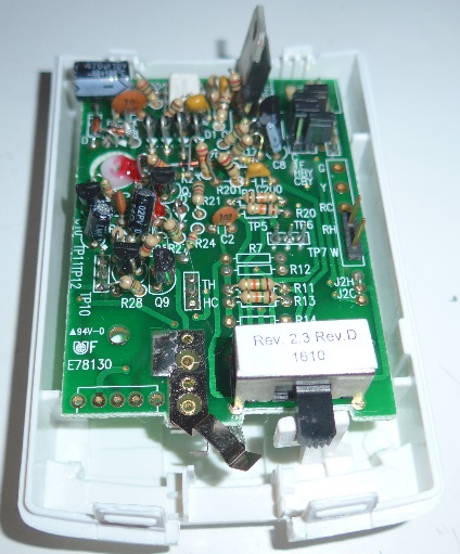

As for the thermostat, while this is the one in my house, it is no longer generally used. Partly it is pretty old tech nowadays, lots of through hole parts.

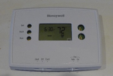

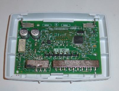

So I picked up a newer one at Home Depot (less than $20), which will be a better example for others, this is a Honeywell RTH221B
And the more modern all SMT design.
I plan on using the housing, power supply, relay, maybe temp sensor and interfacing those to the WiFi module. It should save a lot of time.

Not a lot of useful progress today, but you learn by experience. The original thermostats were mercury switches on bimetal strip springs that rotated with temperature change. When it wanted heat or cool, the mercury switch would close and present a dead short to the 24VAC coming to it on 2 wires. Not much has changed, the digital thermostats read temp from a sensor and trip either a big transistor through an opto-isolator, or use a small relay to do the same thing. Not much in the way of progress, but that makes the heating system compatible even with those old mercury switch thermostats.
So what happened, I was checking out voltage levels when the thermostat was requesting heat. I guess I didn't believe/know that it would be a dead short at the thermostat end. That blew an internal fuse on the transformer I picked up at Ace. I guess I could fix it, but as it turns out both thermostats seem to have a full wave rectifiers, so that I can just use my better DC power supplies that have current limits and meters and are generally more experimenter friendly.

Today had to think more about power and did some looking at the Honeywell thermostat and the older Erie one. The Honeywell one seems to run the digital side completely off batteries, which to me is not a desirable design, after all until the furnace controller goes WiFi, it is hardwired to the thermostats. My older Erie design does run off the 24VAC, but has a small hearing aid style battery to run when heat is being requested (ie. the 24VAC is down to < 2VAC).

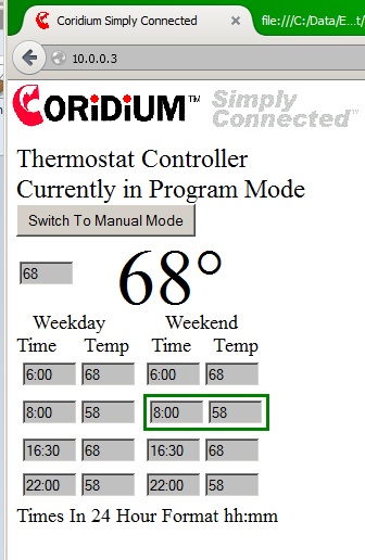

As this is a work in progress, some reading here may be a bit disappointed that it is not a solution yet. And while it seems like I am just poking around, in reality I have been thinking about this for a while, and this journal is mostly about the integration process I am doing now.
The goal of this is to do the thermostat control program in BASIC and for it to also serve a webpage as the interface to the end user. That programming is nearly complete, as that work started a few months back. As I know, hardware without software is pretty useless. Here is a snapshot of the webpage you would see on your phone, tablet, PC, Mac, Linux machine or whatever.
Originally I was thinking of doing some cross platform app. But by going with a webpage, that is about as cross platform as it gets and doesn't require much programming on our side beyond some HTML.

On the programming side, to show the communication between webpage and user BASIC program, these are preliminary sources for BASIC and the HTML. The firmware on the device services the webpage and handles the CGI requests that can set or read values in the BASIC program.
