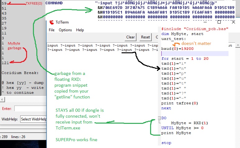

First off - some of this is unorthodox procedure !!
Attempting to create a Serial Comm link with the ARMstamp - I tested the ability to TXD first. -- Works,but
did notice some "funnies" - a different Forum post.
Did not connect the RXD line - (so it is floating?)- but later on did a RXD test and got the "garbage"
as can be seen in the "Debug Variable portion of the picture" - code snippet/function was copied from
one of your forum links re: serial. called 'getline' - [OEM current testing via SPI devices]
connected RXD to the Coridium Dongle and I get nothing - not even 'garbage'/CR/LF- from TclTerm which is
connected to the Dongle
tested on ARMstamp Production and Beta unit - both fail ::: SuperPro works fine on BAUD(0) & TclTerm & Dongle
Could you verify RXD works at 19200 baud on the ARMStamp ???
Olzeke
P.S. a picture is worth ......

The TXD situation was workable.
the main issue was the RXD(1)- actual data getting in.
it is interesting that the floating input , would actually capture the TXD data - for a short while !!
[see the COMMAND data display - that was the RXD(1) data whhile the input was floating !!]
can you test the RXD(1) function ????
Thanks - gz

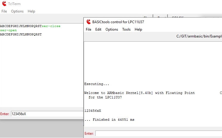

Re: ARMStamp RXD issue
Any floating input can generate any kind of data -- not very surprising.
And this working for me
' this assumes a connection between RXD(1), TXD(1) and some other serial device using TclTerm, TeraTerm...
' tested with a USB dongle and ARMstamp
main:
baud(1)=19200
for i=1 to 20
txd(1)=&H40 + i
next
ch= rxd(1)
while ch<>"X"
ch = rxd(1)
if ch>0 then print chr(ch);

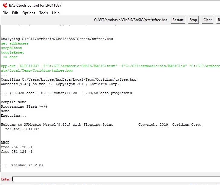

TXFREE works for me. EDIT -- on a newer firmware version.
Not sure it is worth addressing BAUD(0)/BAUD(1) interaction on Stamp, as BAUD(0) would really never get used there. Here is my test code--
main:
baud(1)=115200
free0i = txfree(0)
free1i = txfree(1)
TXD(0) = 0x41
TXD(0) = 0x42
TXD(0) = 0x43
TXD(0) = 0x44
TXD(0) = 10
free0 = txfree(0)
TXD(1) = 0x45
TXD(1) = 0x46
TXD(1) = 0x47
TXD(1) = 0x48
TXD(1) = 10
free1 = txfree(1)
printf("free %d %d %d",free0i,free1i,txfree(2))
printf("free %d %d %d",free0,free1,txfree(2))
In the current release of firmware 8.40b, txfree is broken on the LPC11U37, the ARMstamp
If you really need this function, contact me and I will send a corrected firmware.
