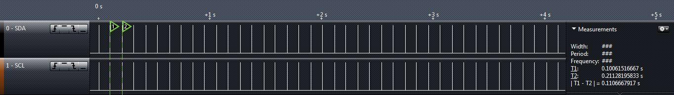

I am having trouble getting the attached code to work. I have my logic analyzer hooked up to the pins 57 and 58. If I toggle the pins using HIGHX and LOWX my logic analyzer picks it up so I know the analyzer is hooked up correctly. When I run the attached code I get this as output
Anyone have any idea what am I doing wrong?

Re: Wii Nunchuck Over I2C issues
Have you got pullups on the SDA and SCL pins?
Could you zoom in on the scope trace?
While the bit bang macros were tested, they were not tested for all pins, the I2CIN and I2COUT rely on INPUTx(pin), OUTPUTx(pin) ,LOWx(PIN) and INx(pin)
you might verify that by writing a program to wiggle pins using those macros and the pins you intend to use.

I removed SET_SCL_LOW; SET_SDA_LOW; Last night (forgot to update forum post). That does solve the problem of start signal, etc not being generated properly. However, Now the stop signal is not being generated properly. I will upload screen caps from my logic analyzer later tonight.
-Dan
