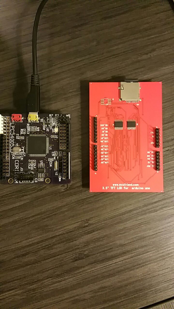

Bruce asked that I post my updated code, as I had to tweak it to get the display and touchscreen operable.
I've the red mcufriend 3.5" touchscreen for Uno. Come to find out, they ship boards that have one of multiple different driver silicon thereon. Code for one might not work with others, especially wrt the touchscreen (and possibly with the uSD).
I'll attach herein both the stock lcd code that shipped with the 54005, and my tweaked implementation that ended up working with the 0x7796 driver ICs. I'll attach a couple demo videos too.

The Coridium stock lcd demo app has a white background and 4 portrait horizontal boxes that change to color when touched and no TS cal on startup. For my hardware, the orientation of the TS was 90 degrees off and no sort of cal would have resolved it. Thus, I todomized it into something vaguely functional, before stalling hard.

My hardware
My hardware
