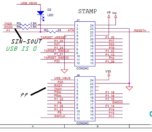

the serial ports are incorrect, I do believe. on the schematic "http://www.coridium.us/files/Schematics/LPC11U37.pdf"
I was under the impression that USB is RX/TX '0'
and the SIN/SOUT was RX/TX '1'
Re: Coming soon an LPC11U37 board
Fixed the schematic, thanks for checking.
BASIC does control UART0 by access to RXD(1) / TXD(1) because the USB serial port is the debug port, which for all our other products is treated as the serial 0 channel..
Yes a bit confusing, but that's the way it is.
