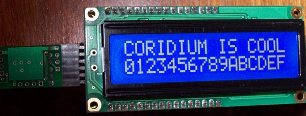

I got one of the special wireless LCD prototypes (uses the BASICchip and a NewHaven display)
http://coridium.us/custom6.php
And have a quick demo running on it in BASIC (source below)

Here's a quick picture of the setup
