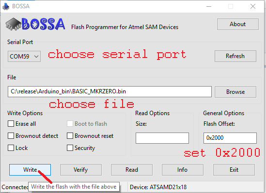

Before you run the BOSSA app, get the Arduino into download mode. Do that by hitting the RESET button twice.
Run BOSSA app
MAKE SURE you set the OFFSET to 0x2000 otherwise you will brick your part and require an ICE download
Choose the serial port
Choose one of the binary files
Set Flash Offset to 0x2000
Then WRITE button.

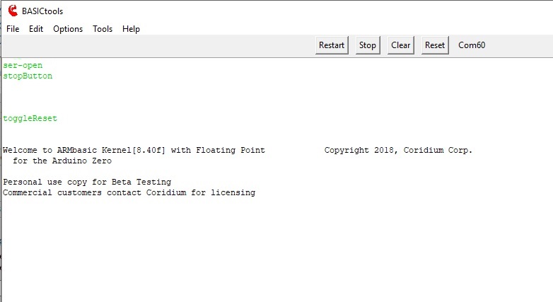

Then restart the Arduino (in this case a MKRZero), and startup BASICtools
You should see this welcome screen and you are ready to write BASIC programs on the Arduino

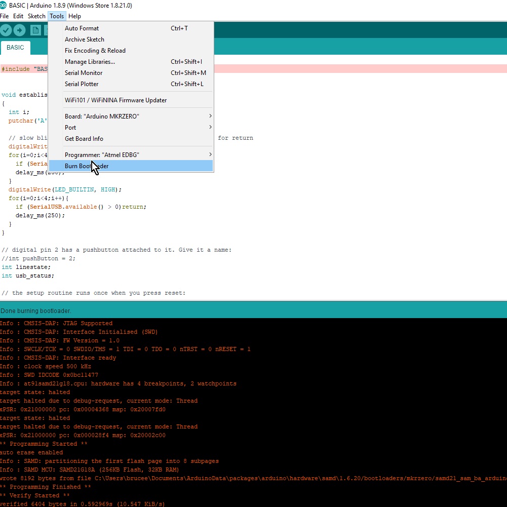

Note to self -- program bootloader for SAMD21G MKRZero
After stumbling around for an afternoon trying to figure out how to load a BOSSA compatible bootloader onto a MKR Zero clone, I accidentally stumbled onto how to do it.
Using a uLink2 connected to the SW debug pins
Use Arduino IDE, under tools select the board -- Arduino MKRZero
and select programmer -- Atmel EDBG (I know the uLink2 is not, but it looks to openocd like it is)
and Burn Program, picture below
