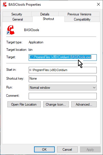

Re: ARMbasic not running in a win32 enviorment
The proper way to install BASICtools on a 32 bit system now is to
1 - download and run normal setupBASIC.exe
https://www.coridium.us/files/setupBASIC.exe
2 - Open the desktop icon that is installed (right click on Properties)
icon
icon
3 - Change the Target value from BASICtools.exe to BASICtools32.exe
