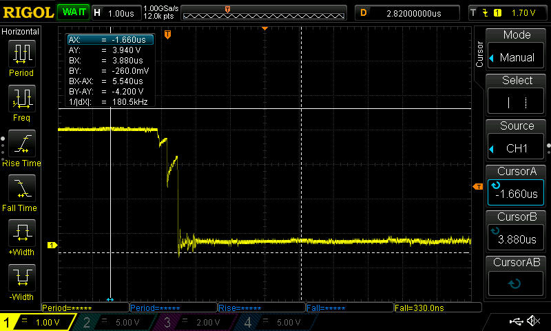

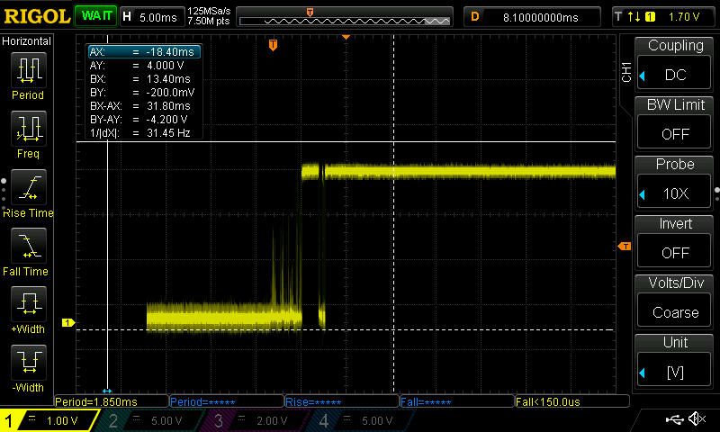

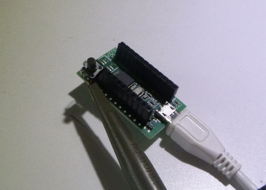

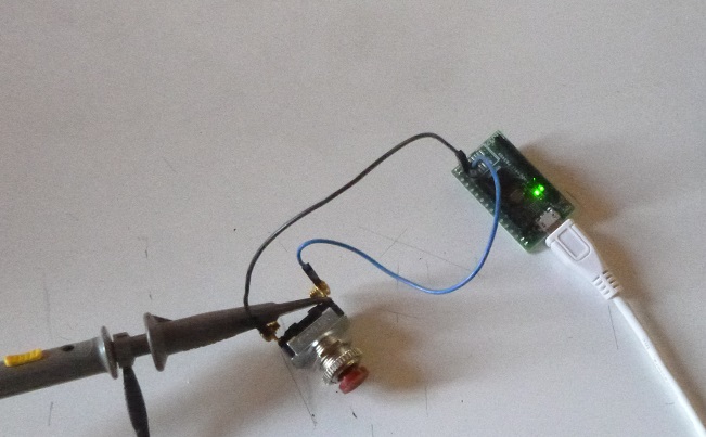

Buttons and switches bounce, and you have to take that into account. The easiest way is to look for a change in the button then ignore all other changes for a certain debounce time. That can vary a lot depending on the switch. I set up a simple test case on an ARMstamp with a push button between 2 pins. One pin driven low, the other pulled high by the internal resistor.
- pb1.png (310.04 KiB) Viewed 33679 times
Then some scope pix show the push is pretty clean, but release is takes about 1/2 millisecond to settle
- DS1Z_QuickPrint2.jpg (85.91 KiB) Viewed 33679 times
- DS1Z_QuickPrint4.jpg (84.28 KiB) Viewed 33679 times
And here is a program to read the debounced state of the button and display that on the LED

Re: ArmBASIC - contact debouncing
Posted: Mon Oct 14, 2019 1:53 am

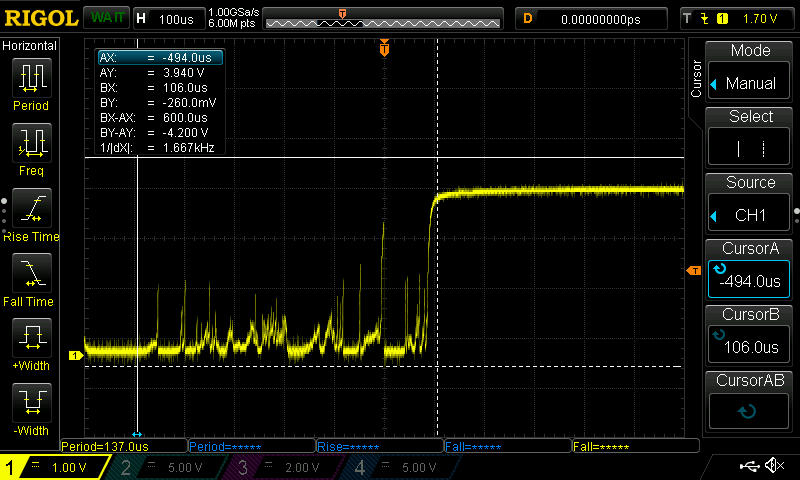

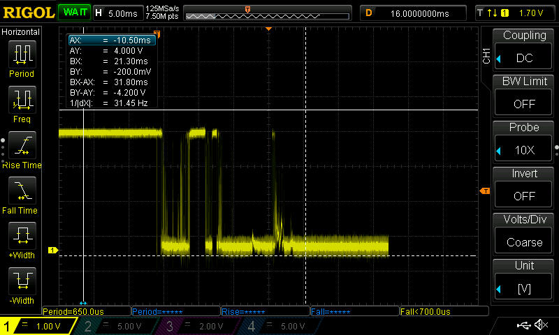

That was a small pushbutton, big toggle switches may bounce longer. If you have a scope you can take a look. If not it you see multiple . printed you need to increase the time.
So here is bigger push button, which is normally a good debounce, but if you do half or slow push/release you can get some ugly pictures lasting up to 30 msec.
- pb2.jpg (91.27 KiB) Viewed 33672 times
- DS1Z_QuickPrint5.jpg (83.67 KiB) Viewed 33672 times
- DS1Z_QuickPrint6.jpg (82.24 KiB) Viewed 33672 times

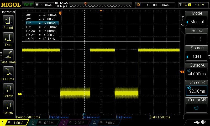

And for reference I did some fast clicking on the small button.
Seems like about 100 msec is about average for a quick click and a double click occurs in about 300 msec (100 low 100 high 100 low)
So for that little push button a debouce time of 20-50 msec would see a double click. Bigger buttons longer travel times, so you might need to adjust.
For my thermostat project, I will be implementing an interrupt driven version for 2 buttons, and will post that code here when done. For that the CPU will be sleeping to save power, but a button click will wake it up as well as timer interrupt to make temp measurements.
double click --
- DS1Z_QuickPrint1.jpg (82.55 KiB) Viewed 33621 times
