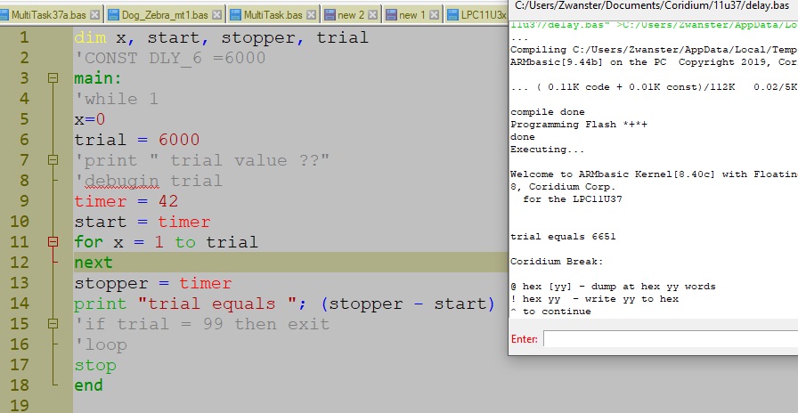

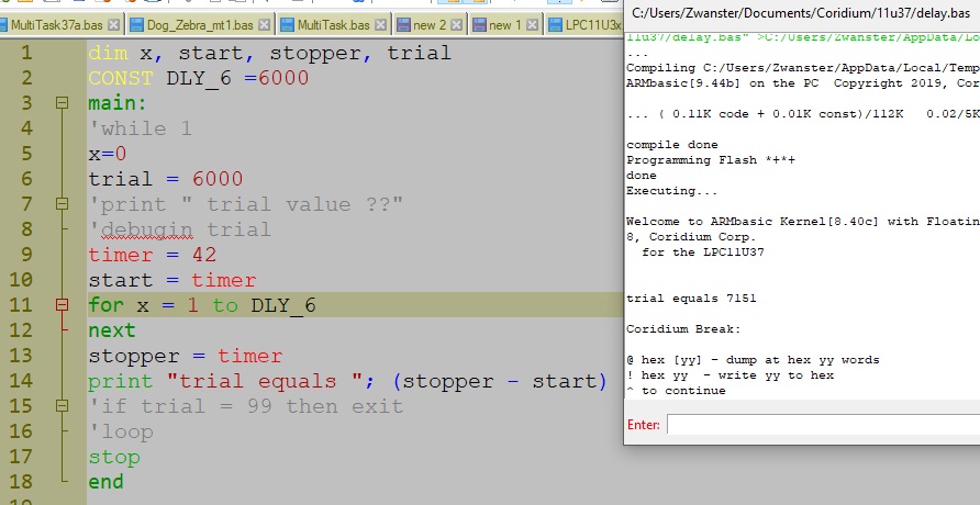

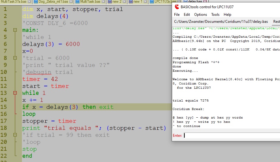

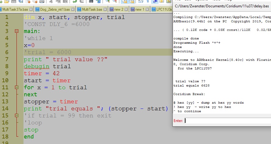

here are screen capture of the program listing and its result inBT
This is for the WHILE..LOOP conditionals
Re: Timing Loop Variations
two more for WHILE..LOOP
these are for the FOR..NEXT loop
the rest of the FOR..NEXT loops
while x
x=x-1
is the fastest (an IF test and EXIT lengthens the loop.
There will also be variations depending on the size of the constant. ARM assembly allows 8 bit values to be loaded in one instruction, some constants can be done by combining shifted constants. For longer one a PC relative load is used, and depending on the context of your code, this can add a branch around the constant.
Variables are done using register relative load and store, so the first 32 variables will be the fastest. After that multiple instructions will be required.
Tod's EBT can be useful to display the compiled code.
