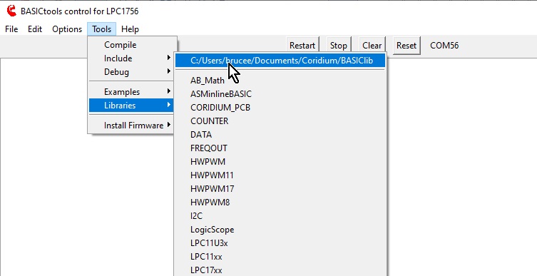

For some reason the pointer to the BASIC libraries is not getting set by the installer, still looking into why
But you can set it manually in the Tools menu, and that setting will be remembered. They are in your user/documents/coridium/BASIClib directory

Looks like Windows update has struck again, the installer commands to write pointers for Coridium into the registry are not happening. So I am working on a workaround.
Re: Pre-processor error
Posted: Wed Sep 02, 2020 9:05 pm
Thank you for the report, the installer has been fixed to not rely on the Windows registry to find the BASIC libraries and Example directory.

Ok, installed your workaround update and it works!!
