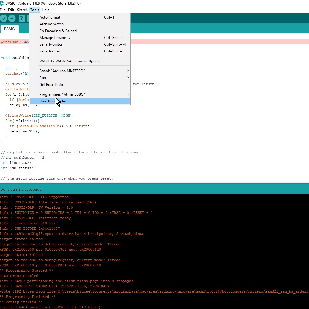

Note to self -- program bootloader for SAMD21G MKRZero
After stumbling around for an afternoon trying to figure out how to load a BOSSA compatible bootloader onto a MKR Zero clone, I accidentally stumbled onto how to do it.
Using a uLink2 connected to the SW debug pins
Use Arduino IDE, under tools select the board -- Arduino MKRZero
and select programmer -- Atmel EDBG (I know the uLink2 is not, but it looks to openocd like it is)
and Burn Program, picture below
