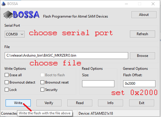

Before you run the BOSSA app, get the Arduino into download mode. Do that by hitting the RESET button twice.
Run BOSSA app
MAKE SURE you set the OFFSET to 0x2000 otherwise you will brick your part and require an ICE download
Choose the serial port
Choose one of the binary files
Set Flash Offset to 0x2000
Then WRITE button.
